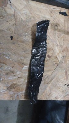

This post looks familiar or I'm having dejavu??? Take some pics. I put LED in my aftermarket lights and my end cap did not fit. Had to do some retrofitting. This stuff might help you out.
