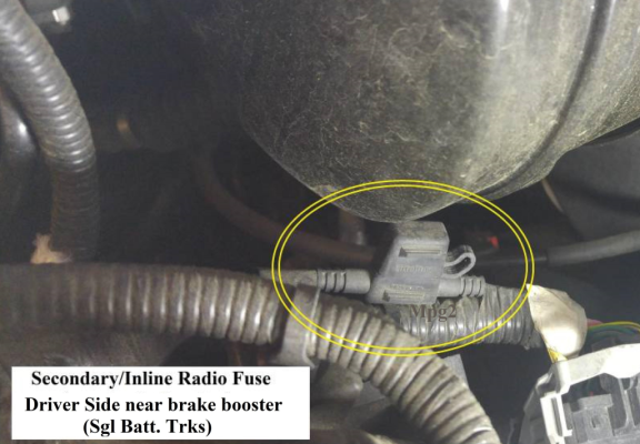

I looked for a fuse under the hood but didn't see "radio" anywhere. Is it linked to something else?
Yes, there is an inline fuse just in front of the battery and the brake booster when looking from the driver side fender.
Have a look under the brake booster for the inline radio fuse.

Pulling fuse didn't help. Guess I need a replacement radio
