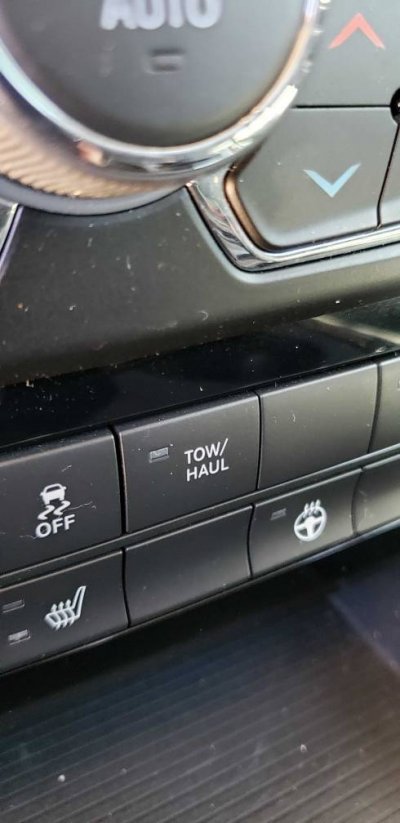

Hi all, my truck 2015 1500 Sport 4x4 5.7L came with the hitch tow package. Do I need to buy a electronic tow controller if I'm towing an electric brake trailer? Please advise, what is the purpose of this button? Thanks 5ad83c572bfc4f34a302e0e320a376f0.jpg62ce745df3321c0f440cc8d877d0ef5a.jpg

If your truck came with the brake controller it would be just to the left of the buttons on that panel. All tow/haul does is hold the shift points longer, has nothing to do with electric trailer brakes

Got it, thanks. I purchased a tekonsha one
