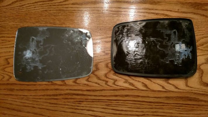

Did you check to see if just the mirror glass (alone) is available just for the sake of cost comparison? A lot of parts guys quote the whole mirror assembly not the glass. Sometimes it's hard to find the glass in the parts, I was told. I don't know on the Ram, but on the Jeeps, it's a 5 min replacement process (with heated).
As I recall on mine, what happened is traces corrode due to the elements (salt!).
Looks like there's a $25 glass on Amazon that could work. I'll have to check to see if I can get my glass off. Maybe the connections just a bit corroded like yours. Being in Michigan I know all too well about the salt plus this truck came out of Quebec. [emoji23]
Probably still end up getting tow mirrors in a few months but this may be a cheaper solution for now.

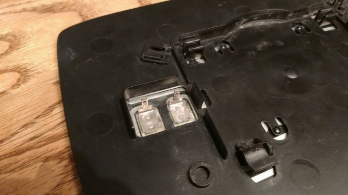

I finally got a replacement glass for the mirror. Pulled the old one apart and here's what I found.

can you supply the correct oem part number you are using? thanks
I wish I could provide a good answer but I honestly don't know what the OEM parts number is. I just searched on Amazon for mirror glass for my 2010 Ram and picked the one that said it fit and was on available to ship immediately.
Here's a link to the one I got but it looks like they're backordered a bit. https://www.amazon.com/dp/B00EC0YNLQ/ref=cm_sw_r_cp_apa_NySrAb79JNTH2
