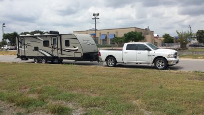

I'm towing a 32' TT that weighs 5900lbs. On my longer trips, I have averaged 8.5-9.5 MPG. The speed and grade of roads make a big difference. I usually travel right around 65mph. If I kept it under 60, I'd get a lot better mileage. My signature isn't showing up, but I have 3.92 gears.
