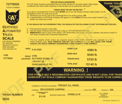

Without going into a ton of detail if you pack light, under 1000 lbs of cargo you are going to be right at the max payload of your truck. This assumes two adults, and 2 kids, and a basically empty bed. In fact you are not going to be able to use your bed at all.
I have a 2500 cummins with a 2200 lb payload capacity. I tow a longer trailer but with similar weight specs. With 2 adults, two kids, 2 dogs, and a few hundred lbs of stuff in the bed I am routinely at 2000 lbs of payload when factoring in the tongue weight.
Below is the data for a weekend trip. When I take longer trips in the summer I have to be careful about overloading the truck bed. Payload is at 1740 in this setup. Tongue weight is at somewhere between 800 and 950 lbs.
392DevilDog
Aug 25, 2019
1,954
2,956
Glasgow, Pennsylvania
392 Hemi
I have similar payload needs.
I would love to see some scale slips of these 1500 trucks going to camp with a 34 footer 5 family members and a dog. Bed loaded with wood bikes and chairs grills etc.
I see your Cummins puts 500 more pounds to the axle. And I obviously have more of my load in the bed. This was family of 4, wood, bikes, kayaks
