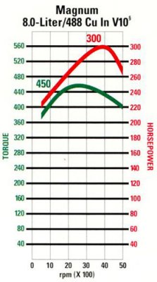

I love my 6.4l but my 8.0l has a much nicer sweet spot.
310 horsepower @ 4100 RPM
450 torque @ 2400 RPM
