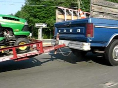

In my experience with towing on the bumper, you'll more than likely end up causing some sort of damage to your bumper. Our trucks sit so tall vs what they use to it causes the trailers to be tounge high. That angle has a good chance of placing a dent in your bumper. Other than that there's nothing wrong with it.

This pic is a little exaggerated but now make a turn and you can see how it could dent a bumper. I have 2 suggestions. 1 order a Curt 1333 hitch if your some what handy it's a easy install and they are like $60-$70 on Amazon. Number 2 rent a truck from home Depot or a equipment place that way you can get one with a flatbed. You can take the risk of towing on the bumper but might cost you some body work.
