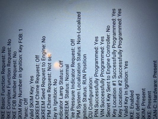

Update ... Under Alfa -Car config change - P/T Chassis Network: CORAX. I have this switched to "SET" and now the Tire Pressure Light comes on and says "Service Tire Sensors" on Evic. I think this is a good sign, but think i have wrong sensors..

We are both on the same track. I did not get a picture of it, however, when I have base tpm set on and premium set on the dash shows - - for tires. Now if I turn base tpm off and leave premium turned on I get 0 zeros. I turn on the corax and it did nothing for me.
So I checked all the pressures in the tires fronts 70psi, rear 60psi. Went into Alfa and adjusted the threshold to 75psi all the way around, reset win and let the truck sit for 30mins. Came back to the truck cycled the key and started the truck, check tire pressure light and message popped up. So I aired the tires up to 80psi, took off down the road for a road test…..an hour later came back defeated with the light still on. I couldn’t get the light to turn off either until I disabled premium tpm, reset win, light and message gone. So I turned everything back on base and premium and I’m back to dashes again. No tire light on though.
I checked for power at the connector for the module and it has power, so I ran the system status and this is what it told me, 315mhz….but it’s only 0-50psi, how is that possible when this is the correct part number. I’m not sure what the next step is I suppose getting 315mhz sensors and just seeing what happens maybe, I have tried 433 and then a hybrid that is suppose to supply 433,434 and 315 signals but knowing Chrysler it will have to be a dedicated 315mhz to work.
