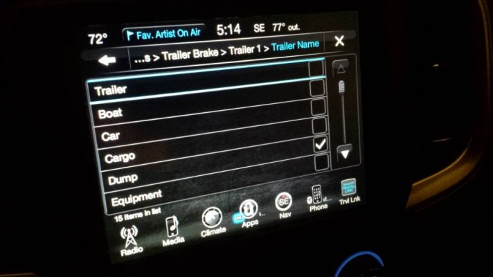

I would reccomend the factory brake controller. They work great and are completely integrated with the truck. The controler also fits well and looks nice in the factory switch panel. I use mine all the time and I love it. You can save trailer types and different settings in your settings menu plus name your trailers if you like. You can also have the trailer gain show in the EVIC on your speedometer if you chose. You can buy the kit online and install it yourself. You will need to have the codes enabled by the dealer or use the alpha OBD tool and do it yourself.

No you would remove the block off plate that's in the switch panel now and install the trailer brake controler. It's easy to do. The kit costs around $240 dollars. Mopar part# 82213474AB. It is always best if you double check the part# before you order. It's also good to make sure you are getting the whole kit. Some places list the module only for sale without the rest of the kit. From the part#s the 2013/2014 trucks use the same module. The 15/16/17 will not work on the 14. It will usually be much more if you buy it from your local dealer after their enormous markup. Remember you will need to either have the dealer enable the code or do it yourself with the alfa OBD tool. 60d6c25d53eb745538ae05a1b48b6780.jpgb5f1d13ddfee99bdc3fbf87c270777c9.jpg512afd0ed5ba12315e803924ee9f6995.jpg
