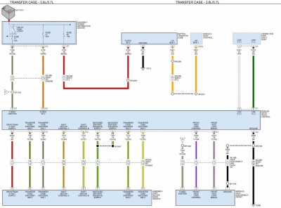

BTW I replied to your thread on the other forum, attached the xfer case wiring diagram. Adding here for posterity :)

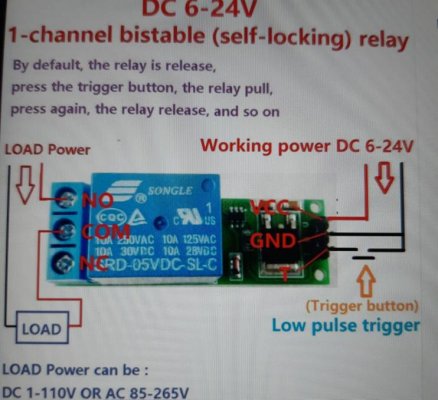

So I found this single Push button relay that may work. It might not be 100% optimal but seeing as how the 4x4 selector uses a pulse resistance on one wire to determine 4 different states this could in theory turn on the lock switch activation so it could be manually be turned on when needed and be "locked out" per say when in 2 wheel drive. Just throwing ideas out. a5ab8c523b00451ece04175082ebff6a.jpg

Like we had talked about before tho it is much simpler to pick Up off of Sig wires for the encoder which this would also work on In Theory. Biggest problem is pretty much idiot proofing it. If I built a latch switch I could use 4x4 and low as inputs to activate and hold the relay and the 2 wheel from encoder to open another relay ground the original circuit and shut it off. Only issue is then when 4auto is selected the encoder motor has already selected 4 wheel drive, this would activate the switch leaving us with the same problem, risking people leaving the switch on. Hmmm [emoji19]
