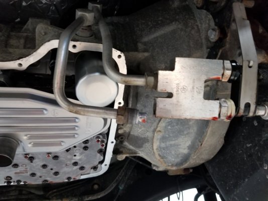

Hi guys first post..2013 ram. I changed my tranny fluid last year. Extracted all I could with a vac extractor that I use for my boat. Dropped the pan.. cleaned..replace filter etc reinstalled pan. Then I basically filled with trans fluid and would run the motor to pump out old fluid about 3 times so I probly replaced 90%+ of my trans fluid. It was a PITA because there is a heat actuated valve in the dist block that had me stumped..don't remember exactly what I did to make it pump out properly bu I think I had to completely disconnect the distribution block. I did make a mess but it cleaned up. Also beware the pan bolts are 5mm (?)fine thread and I stripped 2. However I bought longer ones and was able to run them thru the flange and put a nut on them. Used the Chrysler rtv. It was cheap..like 10 bucks IIRC. Have fun!
