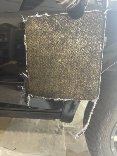

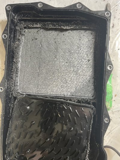

Not sure if this is of any use, but here’s a couple pics of the filter. Definitely not clogged, can see through it.
Anybody who has cut their stock original filter apart,have all noticed the same thing,the filter is along way from being plugged.I'm not sure what micron size they catch,but i don't think they catch much under a 20 micron sized particle,if they did you wouldn't be able to see through them.
Thank-you for cutting it apart and the pictures,it's very appreciated.
It lends credience to my theory the guys that notice better shifting after a fluid change,notice it because the transmission has the proper fluid level if they follow the Green sheet reconmendations,and it has nothing to do with the filter being plugged
