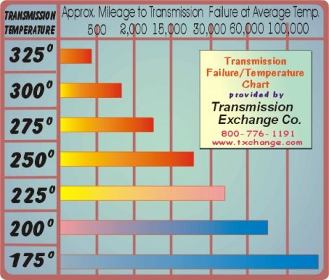

Research ester based tranny fluid, it will run cooler and not break down like regular oil plus 30 degrees F. As a second choice Amsoil is also good. What happens is your tranny oil starts out with a visc of 7, when you run hot and sometimes just normal use depending on the oil, that visc becomes 5. If you tun Amsoil or Ester based your visc stays at 7, thus protecting that tranny better long term.
That could have been the TC or clutch packs slipping, but if you can't duplicate it I wouldn't worry about it. Changing the fluid is a good idea, drop pan change, and look at the condition of the fluid for particles. Change filters and cut them open, is what I would do.
Ester oils defy this chart, but you can see what happens to your trans when it runs hot.
