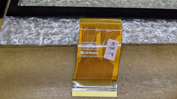

Thanks for checking. This is what the ribbon cables on the 6850L digitizer looks like.

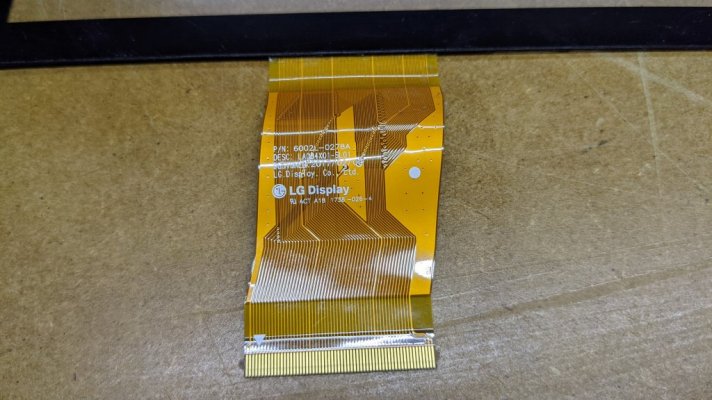

OK, just confirmed two different SL01 screens have two different digitizer P/Ns.
I would think they would be interchangeable revisions though...what makes you think they are pinned differently?

Ahh intersting. If you look at the picture i uploaded of the 6850L, it's different than your 6850L. Your are 100% interchangeable. But the ones i have received are not the same as yours. I wonder why.
Yeah, I see it now...no flipping idea on the why though? Is your radio factiry? Installed?

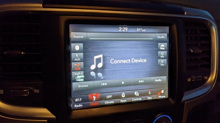

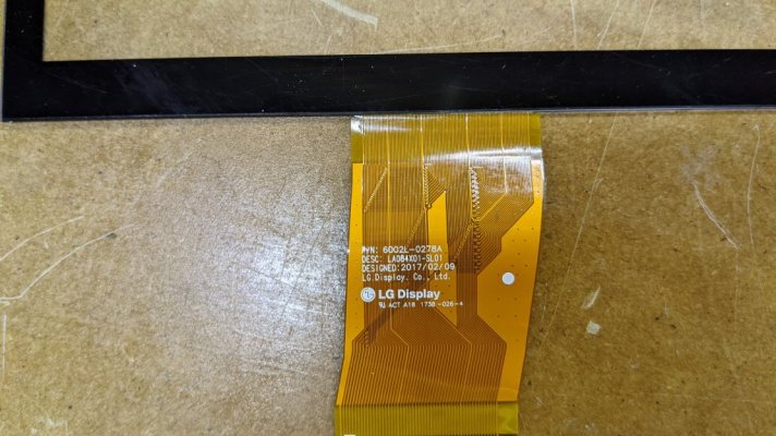

Alright so the one I received today was the correct one.
https://ebay.us/Q8W38g as of 9/29/21, this is the correct 6002L-0278A digitizer.
Around $150 shipped.
It did not come with preapplied tape, which i expected, so i had already ordered 3mm clear double sided tape from Amazon (pictured). I applied the tape first to the DIGITZER side, using the black border as a guide. As long as it's behind that it won't be seen or affect anything. That's there the original tape is placed. The touch zones are slightly more noticeable to me, but also might be due to the fact that my old screen was pretty beat up from normal use. Definitely going to apply a screen protector.
Let me know if anyone has any questions. This was a pain in the *** for me so any help i can provide to anyone else is great. Spent around $1000 on digitizers until I found the right one. (Don't worry I'm getting refunds on all the incorrect ones.)
