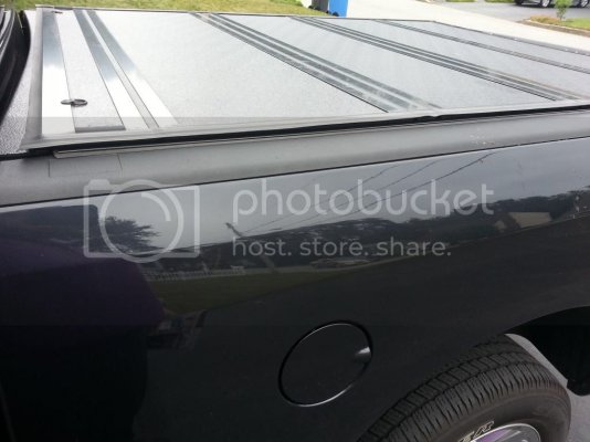

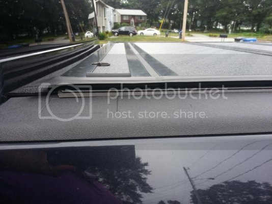

    Can anyone give me some insight on the install of my Bakflip G2...seems like its sitting way too high, wondering if the rubber on the outer edge just needs to settle to cover the gap or if the installation is incorrect...

    It will settle, let it set in the direct sun light

    Just a thought... Your clamps that hold down the rails to the bed maybe too high. Does each section lock into place when you close the cover? My fibermax doesn't have the gap you have in the picture. The seal around the edge bends down a little on mine so maybe settle a little.

    I have no experience with this cover, but it does look like it is sitting high. Even if the rubber on the outer edge did "droop" to cover it, it would look odd to me. I can't imagine that's how it is supposed to be?

    Definitely looks like your rails are off. The rubber edges will settle but not enough based on what I see in your pics. Mine sits pretty much flush with the sides of the bed. I'd post pics but trucks in the shop still.

    I'm going to play with the rails today, hopefully I can get it sitting better...thanks for the input everyone!

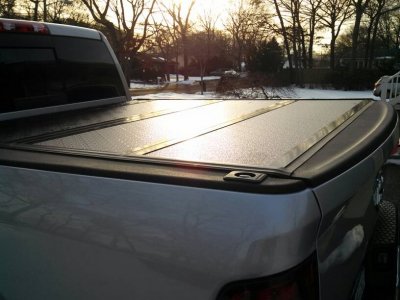

    Definitely looks like the rails were not pushed all the way down before clamping.

    adjusted the rails and it definitely looks alot better, just have to wait for the sides to settle, or I might hit them with a heat gun this weekend.
