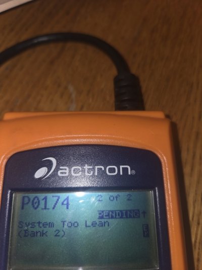

Fuel pump relay is good. I swapped it out with the wiper speed relay and it functions as intended. All signs point to fuel pump failure.1000017653.jpg1000017651.jpg

Fuel pump relay is good. I swapped it out with the wiper speed relay and it functions as intended. All signs point to fuel pump failure.View attachment 581202View attachment 581203
These lean codes could be because it ran out of gas. Check fuel rail pressure or like mentioned, disconnect the line and and see if gas shoots out when you turn the key on.

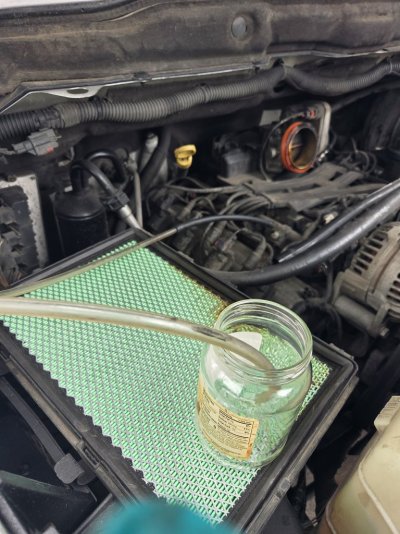

Update: Using a schrader valve tool, I removed the schrader valve entirely from the fuel rail. There was absolutely no pressure or fuel behind the valve. I attempted to start the truck and no fuel came out.
Ok now check to make sure the fuel pump is getting power. If its getting power then replace the pump. If theres no power then theres other issues and further diagnostics will be needed
