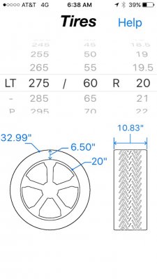

Just measured my 275/60/20 hankook dynapro atm tires at 32 inches. Thought they were 33 inch tires? Am I missing something?

Well technically they're almost a 33" tire and then ya factor in the compression of the sidewall so your measurement should be correct.

The 33" is the inflated height NOT mounted on a vehicle
