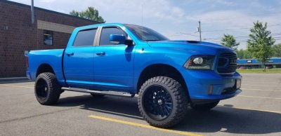

My suggestion is do it once and do it right (coming from someone who did it 3 times) lol. If you hold out and save just a little more zone and bds are great on these trucks jb runs bds which is the higher end of the product. I use zone which is the economical version of bds. For the most part bds and zone have the same parts bds just has a few extras and different coatings if you are comparing apples to apples on their base kit. We both along with a few others here are running their 6 inch lift without the front preload spacer and the 3 inch rear coil option. This provides 5 inches of front lift 3 inches rear leaving about .75 inch or rake. Depending on offset of the wheels it will give you enough room to run 35s or bigger. You will also be able to add to this kit later should you decide to swap to 5 inch coils and adjustable struts to get you in the area of 7 to 8 inches of lift and 37s.

@Tiffbear768 your best bet is a Zone 6” lift you can leave out the preload spacer in the front and order the 3” rear coils. This will be the most versatile lift for a reasonable price. Other companies use different components and spacers in the rear which leaves you scrambling when you decide your changing your configuration (which you will)
My recommendation is do as much reading as you possibly can and learn how each company achieves their height. Then when we give you advice it makes more sense to you. It’s a lot but we have all been where you are now.
