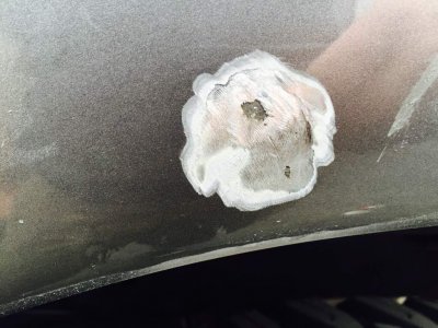

Start with a nice fancy rust bubble. I have multiple on each side so you may see different ones throughout this process.
Grind at an angle, away the paint bubble, and deep enough that the rust is no longer solid. Surface rust is okay, as that will be addressed later on in the tutorial.
This is okay to have.
Now, spray sparingly Rust Mort onto the rusted surface and let dry. Be careful with this stuff as it is very potent, and can harm your skin and eyes severally. Spray a coating of this onto the surface and let dry. Repeat 3 times for best result
Next,(SKIP this step if you are going to use body filler and try to paint match the paint(next section)) wipe the surface with rubbing alcohol, and get self etching primer and use accordingly on the spots. Let dry, add another coat if needed.
Congratulations! Your rust is gone and (from my understanding) should never come back!
