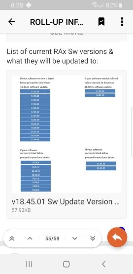

I have a 2016 RA4 and the download worked perfectly. We tried to do my buddy's 2016 and got the same message you did. Do you know what firmware you are currently on? I'm thinking that may be the issue. To see what firmware version you have go to your settings menu and then system information and scroll down to software version. His was currently 16.09.09. This is the message that came up on his and a pic of his software version. The next time he has a chance to come by I'm going to update him to 17.43.01 which was the latest version before the 18.45.01 and see what happens. I'm thinking it just has something to do with the older firmware. Maybe we could compare yours to his to see if that may be the issue. 3a6a5709286bdb7b367a624a8cd6af83.jpg5de618656bc37ca5a8e433fd81ed3069.jpg

There is a thread that was created by Mpgrimm2 that has many of the firmware versions including the 17.43.01. Your truck should have automatically updated to that version through Uconnect but we have seen how inconsistent that can be. You will need to make sure you download the My 16 17.43.01 from his post and then to a USB. I can't get the thread to send to this post so I sent you a P.M with the link. This is a screenshot of the actual thread. 7724cdf22c15c8111d6d7bb84b1f8628.jpg

I just double checked and my radio part# is 68258671AJ. The last two letters are inconsequential so we basically have the same radio and it's definitely a 2016 RA4. Im not sure exactly what is going on but it seems to be something with the 16.09.09 firmware. This version shows that it can be updated to the 18.45.01 in the Uconnect TSB on the pic I am attaching but for some reason it's not working on your radio or my friends. Another thing that is strange is the 18.45.01 firmware is saying the year is not compatible for your radio or his but that version of firmware is not year specific and should work on all the RA4 radios from 2013 to 2017. All the other firmware versions are year specific. I would recommend downloading the
My 16 17.43.01 firmware and seeing if the radio likes it. If it downloads successfully then I would then move to 18.45.01 and see if it works. I'm also wondering why your truck is so far behind on firmware when there are several versions after the 16.09.09 that should have done an OTA (over the air) update automatically. I'm wondering if they have been failing when it tries. It can also be because your not in an area that gets good enough reception for it to work. If it were my radio this is what I would do but remember anytime you update it's at your own risk. It is rare but things can happen.

I just double checked and my radio part# is 6825867AJ. The last two letters are inconsequential so we basically have the same radio and it's definitely a 2016 RA4. Im not sure exactly what is going on but it seems to be something with the 16.09.09 firmware. This version shows that it can be updated to the 18.45.01 in the Uconnect TSB on the pic I am attaching but for some reason it's not working on your radio or my friends. Another thing that is strange is the 18.45.01 firmware is saying the year is not compatible for your radio or his but that version of firmware is not year specific and should work on all the RA4 radios from 2013 to 2017. All the other firmware versions are year specific. I would recommend downloading the
