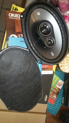

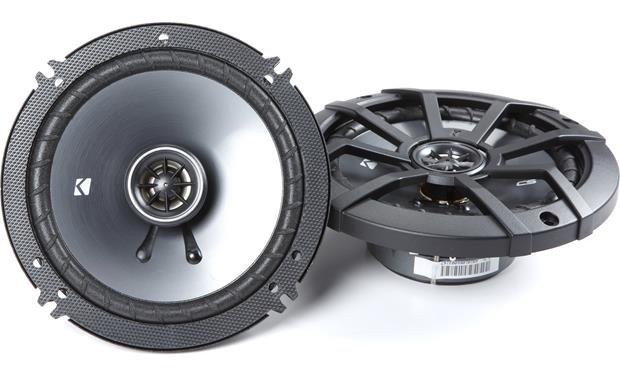

so...as many of you know I replaced all my speakers in my base stereo with Kicker CS series. I was very happy...but something seemed missing. Crutchfield convinced me to put 6.5"
https://www.crutchfield.com/p_206CSC654/Kicker-43CSC654.html?tp=78072
in the front doors since the 6x9
https://www.crutchfield.com/p_206CSC6934/Kicker-43CSC6934.html?tp=91
because the 6x9 were too deep to fit. Well. I sent the 6.5" back and got another pair of the 6x9 for the front doors along with some 1/4" cnc machined plastic spacers and they fit perfectly!
More importantly....the sound is now SO MUCH FULLER and better all around. I am very happy with this...and I strongly suggest that you use these 6x9 brackets for WHATEVER set of 6x9 you want to put in the front doors!
Well...that's my update. The sound is now more full, better mids, better bass etc.

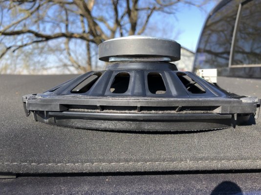

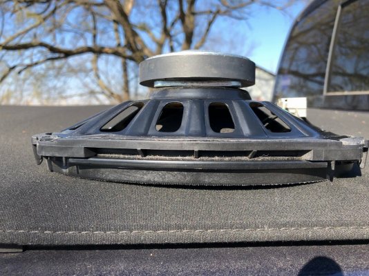

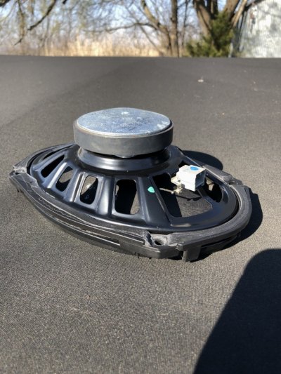

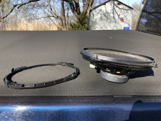

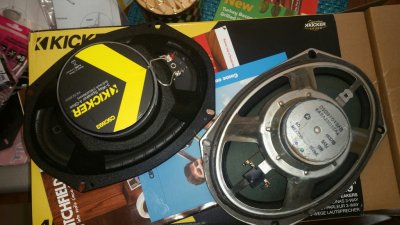

Well, lookie here....lol. Just thought I’d share this finding of mine with all y’all.
I just noticed something on the factory front door speakers of my old Ram(the 2008).....
I had to order a new speaker from some other dealership because I had to change out the passenger side 6x9 sub that blew out long time ago but uh, I just noticed that the front speakers already have an adapter stuck to them that’s removable via four clip-tab thingys..... Hmmm....[emoji848]
Now, I won’t know about my new truck until I go to take the front door panels off but it’s awful interesting that my old truck had spacers to make the factory 6x9 subs fit in the doors....interesting, yes? I thought so....yet based on what the OP said Crutchfield told him, they probably would have been “surprised to hear about the spacers already used to make the factory speakers fit... cf9b5408c2b8d51b2b14b88e2372811a.jpgf5d608473d325928ec797ec0bf96e1eb.jpg68365c0c13f26ad843fb3a3ca0fe9b27.jpg4e478e98c552badc81164c2bc8950540.jpg

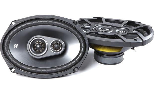

I have no idea why they don't use them. I told a couple techs about the spacers and they seemed surprised. seems like a foolish thing NOT to carry them as they worked perfectly. yes we have the same issue with the front doors, I'd think every ram would due to the window motor track being directly behind the speaker. that's what's limiting your depth.
I put these in with a top-mount depth: 3-3/16" and they fit perfectly with the 1/4" bracket extensions.
Product Highlights:
  • 3-way 6"x9" speakers (pair)
  • polypropylene woofer cone with polyester foam surround
  • polypropylene midrange driver and 1/2" polyetherimide (PEI) balanced dome tweeter
  • handles up to 150 watts RMS (450 watts peak power)
  • frequency response: 30-20,000 Hz
  • sensitivity: 92 dB
  • top-mount depth: 3-3/16"
damn. i'll have to check my stock speakers but I'm SURE they will have bracket spacers on them too. i'll report back when I know for sure....although I DO have pictures here I can post. gimme a minute
JinxCanada
JinxCanada
Oct 15, 2014
765
155
Windsor, Ontario, Canada
2010 Ram Sport
not sure if there are spacers on the stock speakers from just the pictures. i'll have to check when I'm at home
