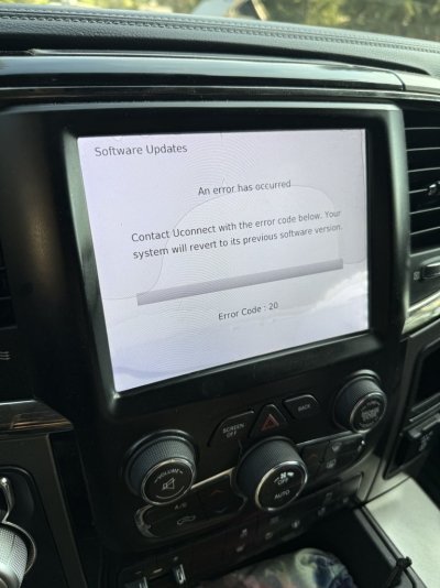

It got stuck here now… I’ve read that I should try to install the version 22.5 but I can’t find it. Any ideas??
It's possible the radio was on this old firmware because it always failed to update. However, it is possible that the reason it is failing is a relatively cheap/easy fix of replacing the Sierra Wireless AirCard AR7552 (about $40-$60). I see the screen is delaminating quite a bit, was there any other issue you had with the radio that made you want to update firmware?

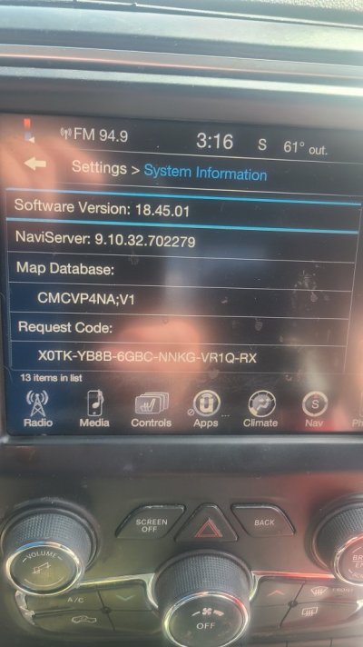

Why does mine have NN instead of US OR Canada. Website says it's up to date. I beginning to think not from the other pics I see in this post.20250831_105318.jpg

Why does mine have NN instead of US OR Canada. Website says it's up to date. I beginning to think not from the other pics I see in this post.View attachment 572161
The website no longer works. I'm not sure why it's still in operation. Yours is not up to date and would need two updates to bring it current (v28.3 and v40.1).
Hey, I hadn't heard back from you yet but I did reach out to someone who was in your same situation and they successfully flashed from firmware v18.13.13 to 28.3 but they had a bad Aircard and had to replace that first.

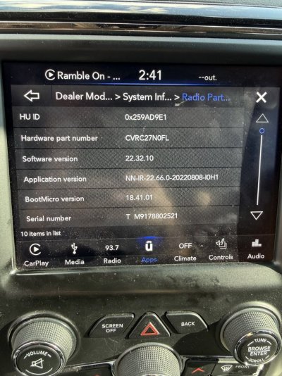

SKB, I couldnt find a way to upload an image in PM, so here is the pic of the info you requested.

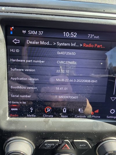

@SitKneelBend can you provide updated firmware for my radio please. I am hoping updates will help with my radio rebooting randomly and having general unreliability issues.
Sure, PM me your Gmail address. You'll need two updates.

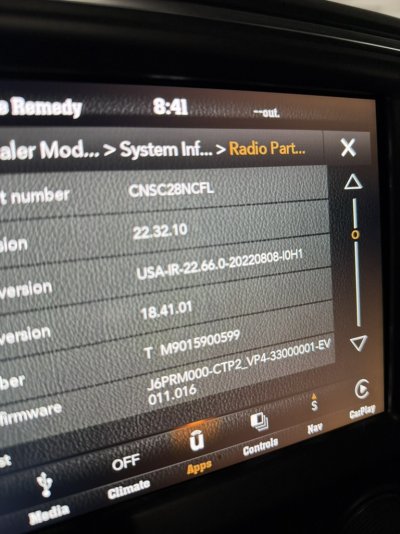

I know this thread is a little old but does my version of the radio need an update? I couldn't find anything that says what the current version is. I also don't know how much dealers charge for radio software upgrades. I got a 2018 with 8.4c I think.
Yes, you are on version 22.6. Don't pay a dealer for this, they will use nothing different from what is available to you and if they break it you will still be charged. PM me your gmail address and I'll send you the update files.
