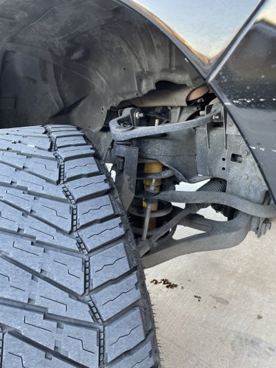

You want something that is NON-angle correcting right? If thats the case options are a bit limited. The Maxtracs are the best option in non angle correcting
Zone UCA's all the way! They are slightly above your price range but totally worth it as long as you are above stock height. Are you leveled?
I believe it’s a 4 inch lift.
If its just a 4" spacer lift kit without anything like bilsteins on higher perch settings then you need non-angle correcting ones from Maxtrac. If you have an adjustable strut on a higher perch setting of 2"+ then you could do zones. If you are not sure what you have post a pic of your front strut.
Is it a zone 4" kit?

Texastrucker
Jan 17, 2022
Texas
