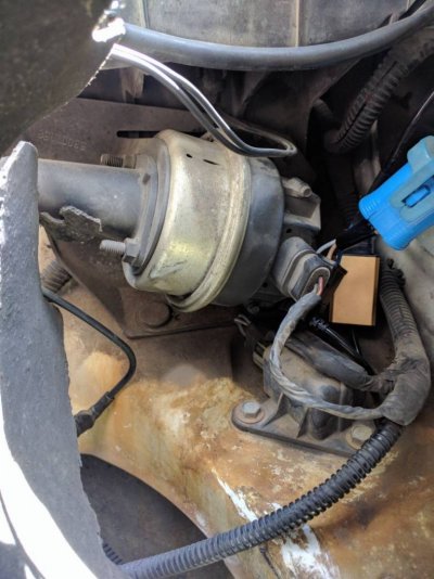

I've been looking for a replacement for mine for a while. It leaks and in turn my cruise control doesn't work. Then again I think mine is different from yours. This is what leaks on mine.27a1bc3743a0aa45409dc4649521e74a.jpg

I took a quick look under my battery box last night and all I found was the cruise control unit as well. I didnt remove the box tray to see if anything else was under there but there is a section you cant see under because of the way the tray is made so I guess I need to pull the battery and see if any thing else is under there. I hope dodge didnt do something stupid and make the vacuum canister as part of the cruise control and you would have to replace the unit. That would add a lot of extra cost to a simple repair!

it's under the battery tray
