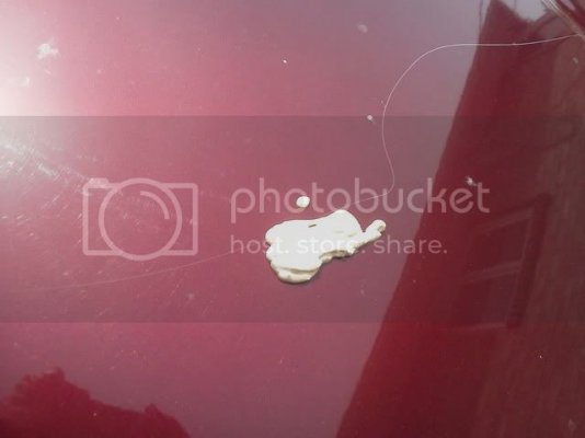

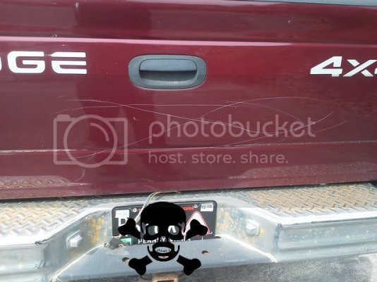

So couple weeks ago a coworker had words with our asset manager over company policy about company trucks, coworker got drunk a day later and took his anger out on asset managers personal truck . He slashed all 4 tires twice, ripped valve stems out and scratched the paint all the way around the truck
I told asset manager I could wet sand and buff the scratches out..... had my work cut out for me :grd:
hood
Tailgate
Now
Hood
Tailgate

came out good. did he file a charge against the guy.

Wow very nice job! Wouldn't think you could fix that.
Thanks !
Yeah that's what most people would think, been buffing and painting cars since I was 14. it's 32 years of knowlege. My Dad owned a car lot I know all the tricks in the book :naughty:

Looks good!
What product did you use?
Thanks !
I use 1500 grit wet sand paper and 2000 grit wet da sander made just for wet sanding new paint and then 3m compound with foam waffle pad
and Zylmol wax (think thats's how ya spell it)
