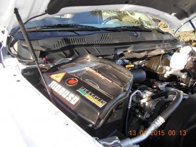

PCV pipe would be your cheapest way to make the 90 degree bend off the bottom of the vararam,and build a smooth tube back to your throttle body,then you'd have to fab up a couple pieces of flat steel to hold the vararam in position.I built a top for my old Air Raid box (aka S&B) and added a ram air tube to it ,that picked up air from the front bumper.
You can just barely see the mouth of the ram air inlet in the pass side tow hook hole

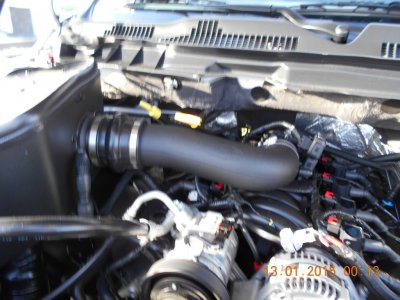

The tube in the 2nd pic is what I'm thinking will be needed. Will have to get some measurements etc. I will have some room to play with as I have a 2500 hood installed.
Appreciate the ideas & pics :waytogo:
and No, wouldn't even know your inlet was down there unless you mentioned it. I'm going to try and keep things higher up inlet wise as to try and limit and FOD or water getting flushed in.

If you relocate the radiator overflow bottle,you can come out beside the radiator.Keep us updated on how you make out. I don't think it's going to be cheap to do,but i definitely think with a little fab work you can put a vararam on a 4.7
