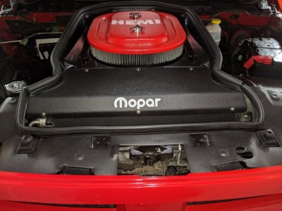

Looks great[emoji106]
What did you use for the weatherstripping there?
Looks like you also upgraded the wing nuts on the lid, where did you get those?

I bought the seal from I think carquest, the seal was just a door seal and the nuts were from eBay.

You can also get the seal and many other forms from "Steel Rubber Products"
That's where I got all mine when I had to build mine up to meet the bottom of the hood and here's a tip;
To permanently bond the rubber to rubber, clean each surface with alcohol and glue the pieces together with super glue.
The rubber will rip before the bond will if done correctly.
