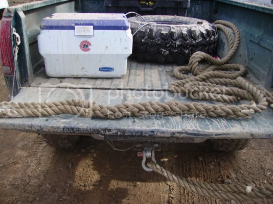

Some people also like to use big rope for recovery which is fine too, so here is what you need to know. How to make an eye splice, and the ropes strength. A knot reduces breaking strength by 40% while a splice retains 95% of the ropes strength. Most people say the rope will break before the eye splice will come apart.
Here is a picture of the splice, literature will follow.

Finished product tested.

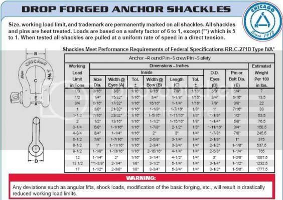

Shackle Information Chart. From http://www.chicagohardware.com/catalog/09_10_shackles.pdf
Here is a pic for those who do not have Adobe reader.

this is a good article. very informative, only problem i see in here is the shackles chart you have there..
i hvae a set of D-ring shackles hanging from my hitch ( instead of a cow bell), and that first one you see, it a 5/8ths.. your chart says 3/4 ton.. my ring has stamped into it that load bearing is 27 ton.. its what we use to lift our firetrucks when going by crane.. dont ask how i got it.. but its stamped right in there..

all i know is i have pulled out, and been pulled out some pretty big opps.. so i know my rings hold up.. heck, look at the picture of the rope and look at the hitch its hooked to.. thats maybe a 5/16th.. i have the 5/8ths... but anyway..
