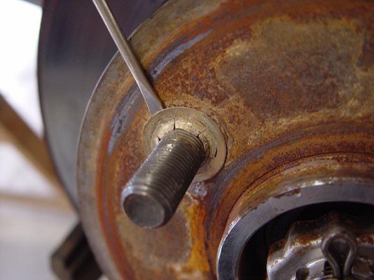

you might need hubcentric spacers if its those fuel wheels you mentioned in another thread
also make sure these clips have been removed

Thanks for the recommendations. I did get hubcentric adapters from motorsport tech. I had them installed and they did remove this clips. When the kit was installed, they set the bilsteins to level the truck. I dont know the exact setting. I will check with the installer on Monday. I'm debating having them lower the bilsteins and getting it aligned or just leaving the bilsteins as is and trying a realign. I don't want to pay for 2 realigns. I am also trying to set the air pressure to 45 from 40 and see if that makes a difference.
