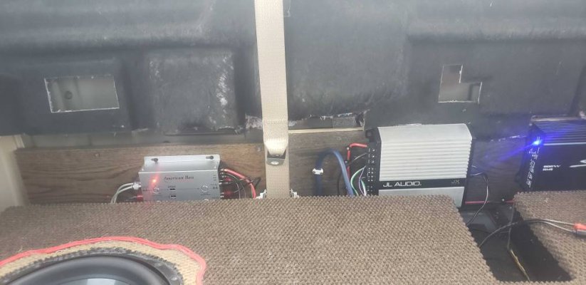

Dec 12, 2018
81
37
Charleston S.c
16 laramie
I know the one in the pic is skar a friend was selling it and I wanted to see how it was (trash ) 2 jlaudiow3 send into protect after 10 mins or so you cant even touch the damn thing that's why rca is unplugged1d3b69db6fc55fdf00fccbb3efec02d3.jpg4cab7809a8dd75f21e079e8d0eb72872.jpg
