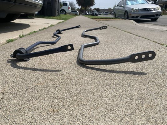

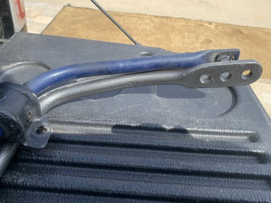

I have the Hellwig rear bar on my 4X4,but if i was doing it again,i'd go with this one instead.The Hellwig is 7/8" while the Etrailer bar is noticably heavier at 1 1/8".
https://www.etrailer.com/vm/Ram/1500/swaybars
Thanks for sharing that. The stock sway bar is thicker too, but it's not solid like the Hellwig. Is the Etrailer bar solid as well?
That has to give you a harsher ride though. I can't speak for the OP, but most 1500 owners want to maintain the smoother ride you get with a half ton pickup.
When i talked to them,they said their bar is solid. The other option is to adapt the 2500's rear swaybar to the 1500's brackets,as the 2500's have a bigger bar.But it takes a bit of adapting to make it fit the 1500's swaybar mounts
That's a substantial difference if theirs is solid. I might have to upgrade to that bar before my next truck. :waytogo:
