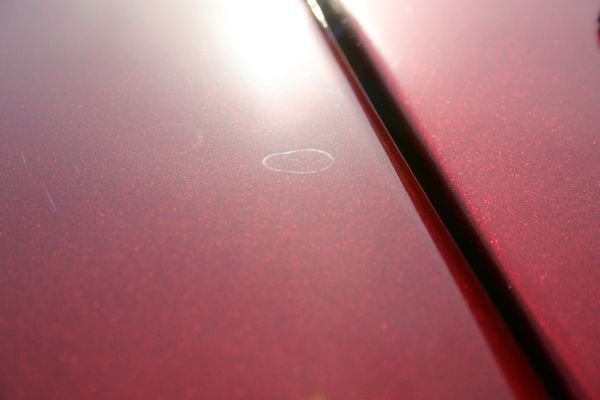

First you have to figure out which type of water spots you have?
There are two basic kinds of water spots or water marks found on automotive paints.
Type I Water Spots - Above Surface Mineral Deposits
Type II Water Spots - Below Surface Water Spot Etchings

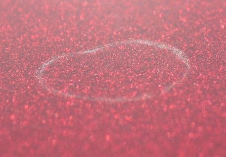

Type I Water Spots
Type I Water Spots are what what we call Above Surface Bonded Contaminants. A Type I water spot is some type of deposit, often times a mineral deposit that was suspended in the water source to begin with, then after the water evaporated off the finish the mineral is left behind where it bonds to the finish usually in a circular or pattern or shape.
Type I Water Spots - Mineral deposits sitting on top of the paint

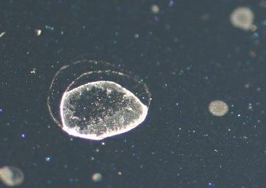

Type II Water Spots - Etchings below the surface
Type II Water Spots are what we call Below Surface Defects. A Type II Water Spot is actually an etching in the surface where whatever was in the water was strong enough in its chemical composition to actually eat or dissolve the paint and thus etch into the paint.
Close up of same photo above
Vinegar might remove a Type I Water Spot but anytime you have an etching in the paint the only way to remove it is to remove the paint surrounding the etching until the upper surface is level with the lowest depth of all the etchings you're trying to remove.
If you have Type II Water Spots then you'll need a compound and a polish.
