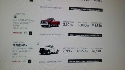

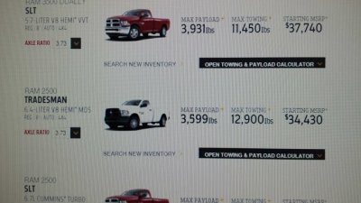

Just wanted to put this out there because i found it interesting..
There seems to be some sort of discrepency and the numbers dont appear to make any sense whatsoever
The top picture is a 2015 the rest are 2014..how can the 2015 tow nearly 5000lbs more than the 2014 and have 400lbs more payload without any structural or component change? Also theres no way the ctd with 3.42 is rated for 17.5k towing but the 3.73 is only good for 13k!?! Dont add up..
I'm going to go out on a limb and say there web page is mixed up. That's the 5.7l towing capability. And if I'm not mistaken the cummins is only available with the 3.42 in the 2500.
