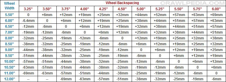

Yes tire size effects pulling power. The larger the tire. The higher the gear ratio. The deeper the gear # (4.56) the more pulling power the larger tire size actually counter acts the gear size. fe3b71295bc26494ea369a8be67eb3ad.jpg
