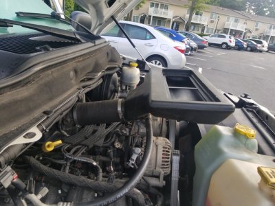

I3 years ago i bought a 2004 dodge ram 1500 5.7 .. it has a srt10 hood with a functional air intake system . I am trying to locate a new air filter. I contacted k@n , and they dnt make one. Also trued to find or look up the air filter n air filter system . No luck can anyone help me fi d a air filter for it. . Or if all possible a new air intake system that works with this hood . Thank you. See pics attached

You can shop by size. Don't get hung up on having one, either. You can butt up two together across that opening.
So measure the opening & the depth, then start looking at S&B or K&N's websites to find either one single filter that fits or two that will make up the entire space.

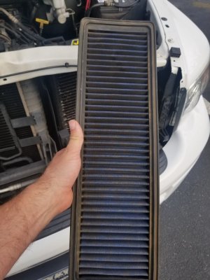

Is that a gauze filter like K/N buy the cleaner and clean it and reoil it.It really doesn't look real bad not as bad as I have seen if you can't you may have to go a different route.

I tried cleaning it n oiling it. It doesnt clean up that good.thinknits shot , proply wasnt taken care of or cleaned wrong before i got truck ,, doesnt pass air threw , prettt clogged.. yes hemilonestar any numbers or help appreciated , thank u

K/N doesn't make the only gauze filter.Spectre sells them .Is there a number on the filter to cross reference from.Look on or around the hood someone made that hood it may have some name or number or look on the cold air tubes. I cannot believe someone made this filter and stopped .Start looking at companies that make filters for semi trucks like Fleet Guard .It might be used for a different application.This sucks man I feel for you.
