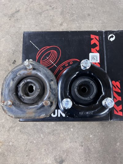

B95CBA1A-0274-444E-949A-FBB0C52EAA82.jpegYour top hats look like this and the puck spacer is also chewed up. @Nick@GotExhaust can set you up with a proper leveling kit. That will also improve your ride
