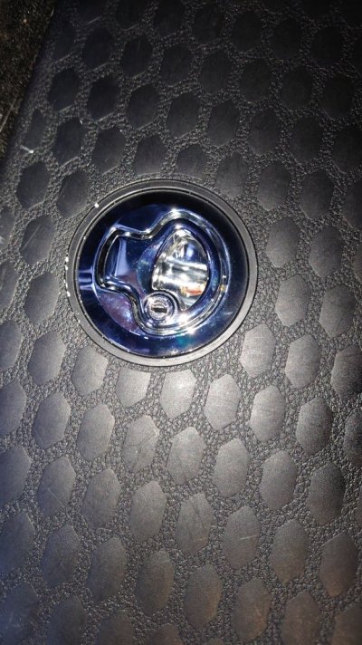

Saw this mod in another post (or maybe this one?) and decided to order the locking latches for my floor boxes. As posted elsewhere, you need to remove the latch side from the old lock and install it in the new one because the new one's latches are too deep to keep it closed.
Here's the process:
1) Order 2x of these or similar (I went with chrome, but there are black ones too): Amarine Made Chrome 2" Flush Pull Slam Latch for Boat Deck Hatch 1/4" Door - Locking Style
2) Once you have the new ones, remove the two screws that hold them into your floorbox lid. Keep the underside of the latch - you'll need it because the one that comes with the new ones is too deep.
3) Remove the old latch - in the hinge, is a roll pin. Use a small alen wrench, hex wrench, torx wrench to push it out.
4) Once you separate the latching part from the rest of the latch, do the same with the replacement latch.
5) You will need to file down the sides of the old latch so it fits easily into the new latch. If it sticks, it won't do you any good
6) Carefully insert the old latching mechanism into the new latch and reinstall the roll pin - don't forget to put the spring back in with the old latching part - you can use either newer spring (stiffer) or the older one (softer) but they both work.
7) Check function, and then using the old underside, but the new screws that came with the new latch, reinstall in your floor box.
8) Check function again and lock away your minor valuables - keep in mind that this is NOT going to stop anyone who really wants in to your floor box - and anyone can probably break into them in about 30 seconds with a good pry.
I can say that the keys match on mine.

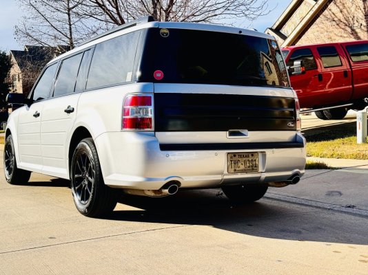

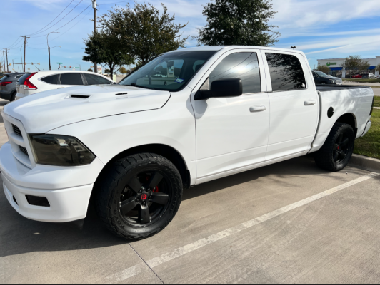

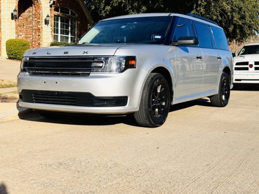

I order some switch backs for the front lights. The LED's have had an error for years and I finally am getting sick of the error message. I also ordered a new pair of lights, and I am going to fix some scratches from where my dad scrubbed a tree when he was driving it. I have a Car show for a sick little girl with cancer at the end of the month so I am in full fix mode and customize mode in both the Ram and My Flex. The Ram is done to my liking, but the flex is still a little ways off.

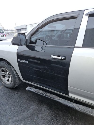

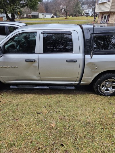

On my drive home from the drug store this evening I managed to miss the first deer... But the next two slammed head long into the side of my Ram.View attachment 535269View attachment 535270
I'm planning to attempt to pull the dents tomorrow.
I found a door on a 2013 ram in the same paint color that's being parted off. I'll be making the 4 hour round trip on Saturday to pick it up.

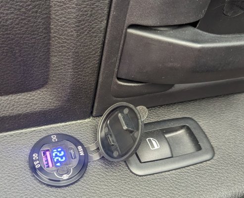

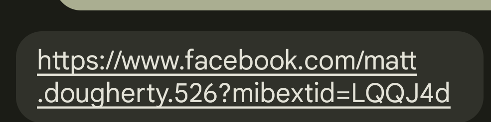

Installed USB power in my rear doors with a little help. Bought the wire harnesses from first link (can't paste actual link, probably because I don't have FB) and made it so easy to do, just plug and play and was about 15 minutes total both doors start to finish. Second link are the power ports I used.
83W 12 Volt USB Outlet Built-in Boost USB C Laptop Car Charger: Ouffun 65W PD3.0 and 18W QC3.0 Car USB Port Aluminum Socket with Button Switch Smart Voltmeter, Suitable for Car RV Marine Golf Cart https://a.co/d/cV3C8qY
