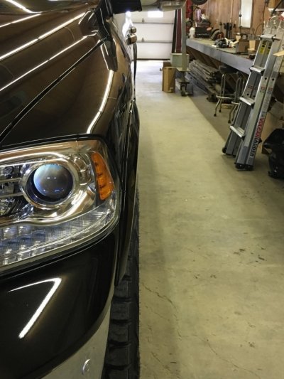

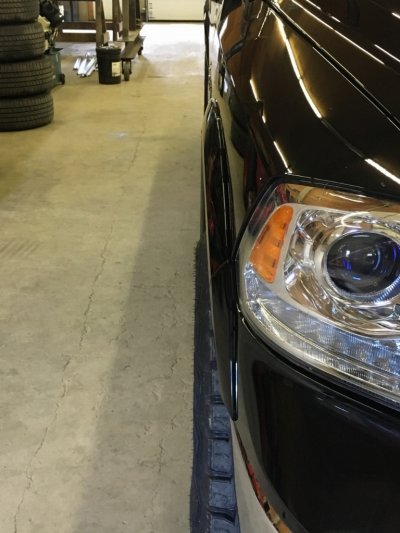

I brought my truck to have it aligned at my dealer today after I put my new wheel/tires on. I did a 2" lift a wile ago and had an alignment after that at the same dealer and it didnt fix it my issue. Is the alignment supposed to fix if the wheel is angled out(sorry for lack of better term)? Look at my pics the drivers side front is straight with the fender flair but the passenger tire is angled a 1" out. If this is supposed to be corrected under an alignment i'm going back Tuesday for an inspection and I will make them fix it.

It's really hard to tell by the pics but one tire should not have more camber than the other. When you go back ask for the alignment sheet when they re-do it. Unless you have something bent they should be able to make both sides even.
Edit: I also remember you have the air suspension. I'm not sure how it works but make sure its in the right alignment mode.

Ok thanks I will make sure I ask for it when I go back in. I made sure it was in the wheel alignment mode before I gave them the keys, and I explained that it had the air suspension and to double check to make sure it was still in it. I will try to go take a better pic too. I just don't know how they couldn't notice how much that side is out tho.. With my new wheels they are +1 offset so they should be almost flush and looking at the drivers side it is straight up and down and almost flush, and the passenger side is almost sticking 1" out with a positive camber.

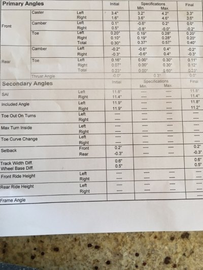

Well I went and talked to the guy that did my alignment and it is true 0. d4dc1950763ef0e1b3e664ac4fca2044.jpg
But he was just as confused as I was on why that tire is sticking out more. We kept looking at each tire and both tires are aligned with the bumper but not with the body... It tracks true and we both looked and the tire does not have a positive camber like I thought.
