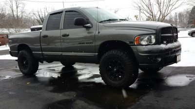

When I turn right with my 2005 1500, I hear a grinding noise coming from the left wheel. I jacked it up, and I turned the wheel, rolled it, tried to wiggle it. No signs of damage. But it still makes the worst sound when im truning right. Help please!
