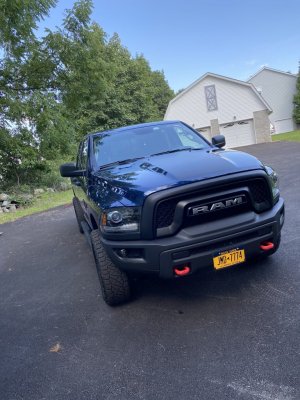

From what I’ve researched, wheel spacers don’t wear out your bearings any faster than wheels that would give you same or similar offset. I’m not sure if that’s 100% true, just what I’ve read. Can’t comment on the towing.
I’m debating taking my spacers off as I no longer have fender flares and the wheels stick out a little too much for my liking. When I had the fender flares, it was just the right amount of poke.
