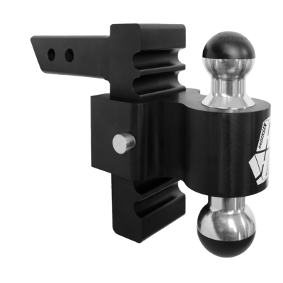

I need a new ball mount. I want to get an adjustable one. Just not sure how much drop to get.
The truck is a 2021 Big Horn 5.7 4x4 stock suspension.
Seems like the most common drop for adjustable ball mounts is 6in? I'm thinking I probably don't need that much since I'm at the stock ride height.
Im thinking maybe a 5in drop B&W.
Or 4in drop Bulletproof Aluminum.
Edit: Just saw this black aluminum Anderson though, but man is it expensive. Id rather have black than some shiny chrome looking thing. But I dont want painted steel.
Thoughts? Suggestions?

Right now I'm leaning towards a 6in drop.
I think at minimum I need 4in. Might as well just get the 6in.
Also thinking of going with an aluminum bulletproof.

Something to consider with a dual-ball configuration like the one pictured. If the hitch is set low, the down-facing ball may see road rash.
As far as cost, quality costs but you only have to buy it once. Be aware that the various hitches also have varying load ratings, be sure to choose appropriately. I went aluminum and I'm not sorry I did. I bought my hitches 10 or more years ago so I'm sure I would be in sticker shock today. But in ten years, you may be the one typing a message like this :)
