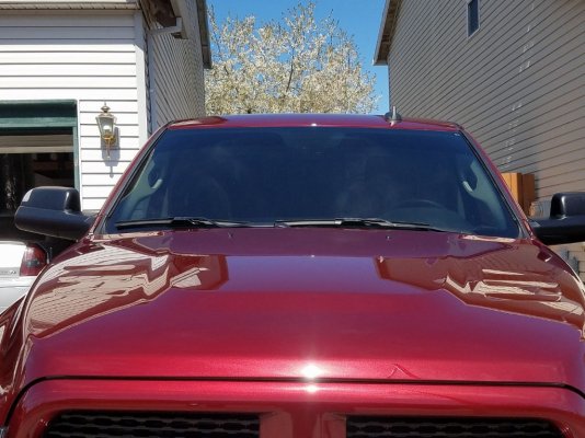

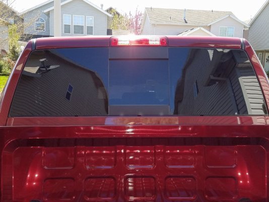

I've always done 5% tint all the way around with a sunstrip. For my truck, the previous owner tinted over the factory tint and I added 35% on the full windshield. The guy that did the tint on the windshield said the front windows looked 20-25%ish and the back windows looked 5%. I think it's a good balance and easier to see out at night vs. 5%. I think you can make out outlines decently when it's sunny out. Nobody realizes the entire front windshield is tinted.

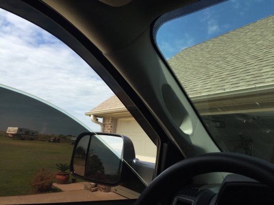

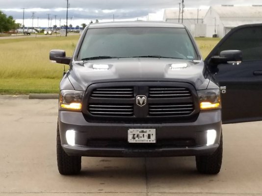

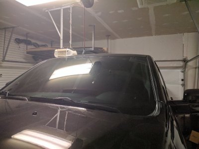

I like tinting mine with multiple layers of lighter tint over each other rather than a single layer of dark tint as it nets roughly the same darkness on the outside while being lighter and easier to see out of on the inside, which helps tremendously at night. I've got 35% over 20% (equals ~7%) on the front two, 20% over the stock 20% (~4%) on the back two, 35% over 20% over the stock 20% (~1.4%) on the rear window, and 50% on the windshield with a modest 5% strip up top. Hard to see in during a sunny day and pretty much impossible to on a cloudy day. Zero problems with nighttime visibility especially after adding HID's and aux backup LED's. I know my way of tint over tint isn't that practical but I've got a buddy who owns a tint shop and doesn't charge me much so I'll gladly take advantage. Hope this helps.
Inside view of 7% on front and 50% on windshield (before strip)
Direct sunlight. Hard to tell windshield is tinted.
Directly into clouds. Can definitely tell windshield is tinted.
