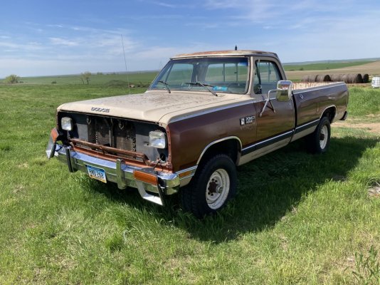

Ok thanks I’ll have to do some reconnaissance on my truck. I had to pull the front off so I could get under the hood
