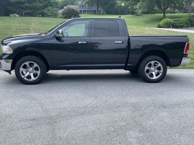

If you truck is like just about everyone else, it has about 2-2.25" rake stock. For comparison, I first did a 1.5" front end lift (1st pic attached), although it still had a rake it looked level. Ended up raising the rear 3/4" to make it look right ,I like a little rake ( 2nd Pic). At 2.8" I think depends on the look you want (and if you haul anything). 1221V springs are the unknown. Know couple guys have done 2"/1", ran into a guy about a month ago had a 3"/1.5" (stock springs) his looked level.
You almost need to put it in, then fine tune the rake you want after it settles via rear spacers swaps, they are easy enough to.
