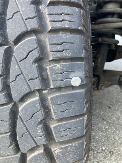

I just got these tires a few months ago and this happened. I know most shops won’t plug it but I have one of the DIY kits, and did a similar plug with rubber cement on a previous tire and it held.
I know the best thing would be to replace the tire but I really don’t want to spend another $300+ when these are practically brand new. Anyone tried to plug a similar spot?

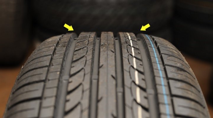

Assuming you don't have a road hazard warranty, take it to a tire shop & see what they say. I googled it & got:
For a safe repair, the puncture must be 1/2 inch away or more from the edge of the tire tread where the internal steel belt begins. Any puncture less than 1/2 inch from the start of the internal steel belt on the shoulder or sidewall of the tire cannot be repaired (highlighted in red).

Is the tire losing air? I had one nearly identical to that. I was going to try and plug it, but when I pulled out the screw it hadn't even penetrated into the belts, and the tire still held air. The screw was about 1/4 inch long. Do you know how long that screw is?

Did you drive it underinflated?? If so there could be damage to the tire from that.
Also further searching turned up this;
https://www.tireindustry.org/tire-maintenance/tire-repair
· The only way to properly repair a tire is to demount it from the rim so it can inspected on the inside, remove the damaged material, fill the void with rubber, and seal the innerliner with a repair unit.
· A plug by itself or a patch by itself is not an acceptable repair because the plug does not permanently seal the innerliner and the patch does not fill the void left by the penetrating object, which allows water to enter the body of the tire and starting corroding the steel belts.
· The use of sealants or emergency inflators that contain a sealant are not recommended as long-term solutions to a flat tire for the same reasons.
· Puncture repairs are limited to the center of the tread area. If there are punctures or damage in the shoulder or sidewall of the tire, it is not repairable.

Thanks for all the replies. Yes it’s losing air. I went on a trip yesterday and got home late around 11:30pm and got back in it today around 4pm which is when I noticed the low pressure dash light on and found the screw, it was reading 24-26 psi this afternoon. Drove around an hour or so and didn’t lose any additional air but have a feeling I’ll wake up to more air lost naturally, and cold air is coming in.
My gut tells me to pull the screw, drill out a nice small hole and work the plug in with some rubber cement or epoxy. (This is what I did with my last tire plug as the hole itself wasn’t big enough and couldn’t get the plug in). That’s what she said. Anyways, worst case if it doesn’t hold it should be a slow enough leak where I get the dash light again and can safely pull off and put the spare on, no real blowout risk.

That location is Borderline safe to repair
It will need a Repair Plug & the inside of the tire will need to be properly prepared & Patched
If it was not going to be used on the highway, you could patch it & insert a Tube, remember them ? :)

If the sidewall didn't get damaged you can patch from inside and it's good to go ..
But don't plug it unless it's just to get you around until you get it properly patched up ... A good inside patch will be perfectly fine ....
When we dismount the tires we put them on a tire spreader and you can then tell if the sidewall or anything inside was damaged beyond repair ....
Pay the $20 to take it to a tire shop and have them patch it ....they will tell you how bad if any damage happened to the tire ...

All tire shops except local independents will tell you no on that repair as it’s too close to shoulder, not inside the last tread line. I can attest that a catastrophic failure on a rear tire can get eventful and you will definitely need to change yer shorts afterword, but I’ve never had a failure after a plug. My failures were tread separations on junk retread tires.
