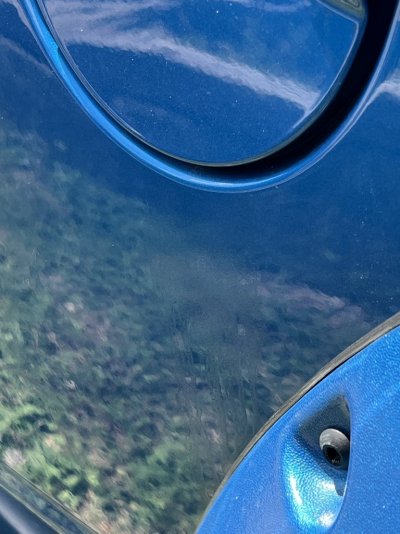

Just noticed this the other day. Under the gas cap. I use 89 non-ethanol. Truck sits couple weeks at a time. In partial sun but not direct at sunrise/sunset. I NEVER drip gas when filling. Tried cleaning it but it doesn't alter at all. So far this is only spot I've seen this. Never seen this anywhere in my life. Really bummed and hoping it isn't a big problem or potentially turn in to a big problem and HOPING there may be a solution?:(

Hard to tell from the pics, but looks as if it’s bubbling. Is that correct? Certainly can see the color discoloration.
How long have you owned it?
Either at the factory, or prior to your ownership almost seems as that that area was not prepped correctly and not cleaned prior to paint.
Great that you don’t drip fuel there, but Granted if your not the original owner, doesn’t mean that has always been true.

Original owner. Brand new in 2018. 12k miles on it now. Sorta does look like bubbling if zoomed in. Easier to see in person than in photos. Never saw this until now 4+ years later....and I monitor the paint because I baby this pavement princess. I wax it seasonally too. I'm thinkin heat related somehow. Just so weird it finally is coming out and near the gas tank makes me think fume related for some reason. Ughhhhh

If it's only occurring below the fuel door I can't imagine you'll get any coverage as they'll claim it's from gas (and it really looks like it is). Any chance of a leaking gas cap? You'd probably get a CEL but who knows.

I don't know too much about the cap-less thing.... do they ever leak? Seems like it would be the same premise as an air-admittance-valve on house plumbing. Things can go in but not come out. And those things fail constantly. I realize I'm down a rabbit hole here but it just seems extremely unlikely that the paint would only fail under the fuel door and it would be caused by something other than fuel.

Is it actual paint bubbling? Can it just be the sealer failing? I would try to strip the sealer in that spot and see if the problem goes away. Just try a real small test spot.

That looks like sealant or ceramic coat high spotting and it reacted with either the fuel "OR" someone tried to add something to your truck ...
Ceramic coatings and sealants if not done correctly will react that way, if you take it to the dealership "DO NOT" mention that you had it sealed or ceramic coated, that will void your warranty for that issue, trust me, I just dealt with a similar issue on a Honda Accord about 3 months ago ...

It's virtually impossible (or at least extremly difficult) for it to leak out of the top of the filler. There is a trap door further down and even if fuel got past that there are drain holes it would come out before it would come out of the end of the filler tube. These drain holes would dump the fuel behind the body, not on the outside.
It sure looks like spilled fuel though, going to be hard to prove otherwise to a dealer etc.

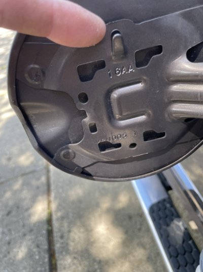

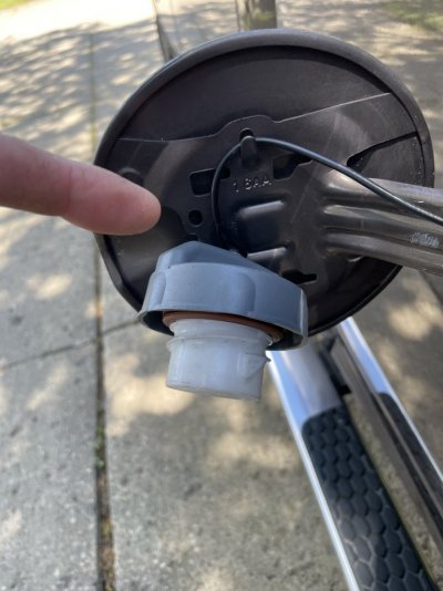

Could be every time you fill up when you remove your gas cap do you let it drop out of your hands and let it dangle and hit the paint, I see so many people do this when they fill up, there’s a lip on the inside of your gas door, at least mine does I hang it on there when I’m fueling up, your probably rubbing some of the clear coat off each time you let your fuel cap drop and dangle and rub the paint maybe ?

Exactly what I was thinking. Thats why I was saying to try and strip a small spot of the product(sealer) where the issue is and see if it goes away.
