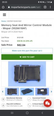

The memory seat modules that need to be added also control the mirror assist when backing up or folding in while parked. How to enable them to work after the fact is still the question.
If "mirror assist" = mirrors tilting down in reverse then you don't need the module you posted. You have to have the power mirrors with 8 wires and the door control modules only.... I have it activated on my 2014. Tazer is the only way to "auto fold" when turning off the truck.
