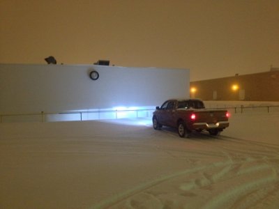

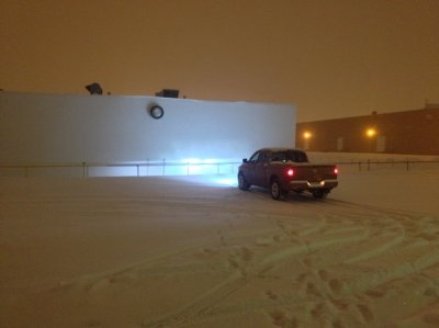

If it's like my Spec-D's were, the hi-beam took a H1 as well. It should say on the housing as well.
I'd advise not going to HID in the hi-beam for now. They take about 10 to 20 seconds to come on full power. The HID's in mine didn't line up quite right which made the light poor because it wasn't hitting the reflector right.
Some of that had to do with the bottom bar on the HID.
Some say there is no problem with HID's in either with the Spyders. I had no problem with HID's in the halogen low beam projector, but had to slightly modify the hi-beams.
I had to slightly modify the spring clip on the back to accommodate the HID bulb as well to hold them in.
If you scroll over the pictures, you'll see which was hi-beam and which was low. There wasn't a huge difference.
I just ran HID's in all because I have to run DRL's.
Hope this helps a bit.
