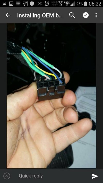

Found these pictures within POST #10 of the original backup cam thread found here .
Sorry Sir I don't mean to YELL post # 10 , I just wanted to put emphasis on Post # 10 ..
https://tapatalk.com/shareLink?url=...&share_tid=53505&share_fid=17770&share_type=t
Installing OEM backup cam
Hope this helps !

Read through post #47 through 63
This may help clear up some of your Qs
I wish I could remember exactly how I took apart the radio C1 connector , it was realy easy as I remember .. something like this. . pop off the red piece , push a white or black slider ( I think) then jently pull out the wires , careful not to pull other wires , I seem to remember once the connector was unlocked you could easily remove all the wires at once .
Hope this helps

In this post you said you had 4 wires going in and three going out ?
Is this the connector your talking about ? This is the truck side of the radio harness ....
The 3 wires going towards the radio is a shield wire (bare) the other two are + video & - video . Power is derived from the +video .
This is my connector the truck side aka the connector you populated from the long body harness . I had 6 going in and 3 going towards the radio . It's important to know the three wires going towards the radio should be in line ( by color ) with the same color wires from the long harnes you populated , all the other wires do not matter for this kit . All the other wires that are not used for a radio display , they are for a mirror displayed back up cam , the extra wires are just terminated in that connector for convenience .
Hope this isn't too confusing .

Oh , for further clarification on the correct orientation and correct sockets in the radios C1 connector : remove the radios C1 connector then look at the radios pins , pin # 31 is clearly marked!
